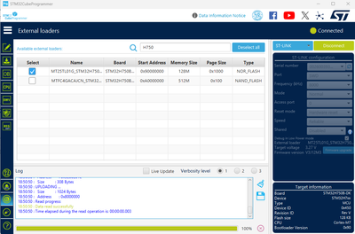

1°) Use latest STM32CubeProgrammer, connect to STM32H750B-DK using STLink.
Enable MT25TL01_STM32H750B-DISCO NOR Flash External Programmer:

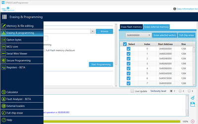

2°) Then Perform a full chip erase of external sector (0x9000 0000 External NOR Flash)
3°) Do also an erase of internal Flash at 0x0800 0000.

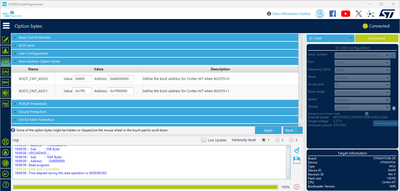

Last point, check Boot address Option Bytes: BOOT_CM7_ADD0, value=0x800, address = 0x0800 0000.

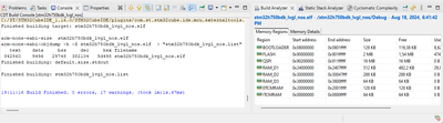

$ git clone https://github.com/rreicher/stm32h750bdk_lvgl_nos.git
Import the project in a fresh STM32CubeIDE workspace locally. Build it and check the result must be the same than below:

- Add external loader MT25TL01G_STM32H750B-DISCO.stldr

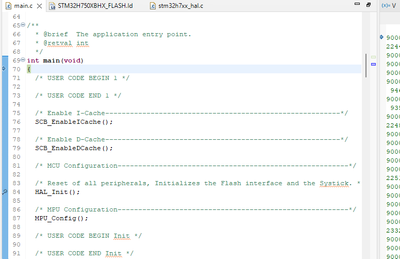

When the windows _binary____ExtMem_Boot_bootloader_bin_start appears, close it and open the main.c file.
Click on Reset the chip icon below:

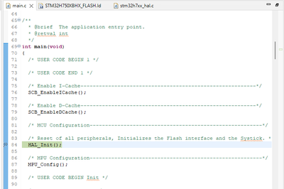

Now you should see debug cursor available at the beginning of main function (line 70).
Place a breakpoint at HAL_Init() (line 84)
Finally click on Resume icon (F8) you should see the LVGL demo on the screen.
