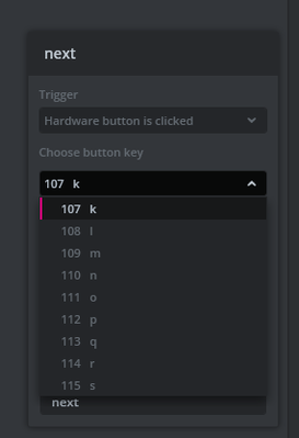

Hello, I would like to know if there is a way to select the arrows keys to interact within the DEMO in TouchGFX?
I can only see letters and some Symbols, but not the arrow keys.
Thanks in advance for your help.

Did you try with the arrows from the numeric pad (8 = up, 4 = left, 6 = right, 2 = bottom) ?
Your trigger should be mapped with 50, 52, 54 and 56 button keys.

Hello Yoann, thanks for the fast reply. Yes this is how I currently use the DEMO mode. I was just wondering if there was a way of using it with the keyboard arrows. Thanks again.
