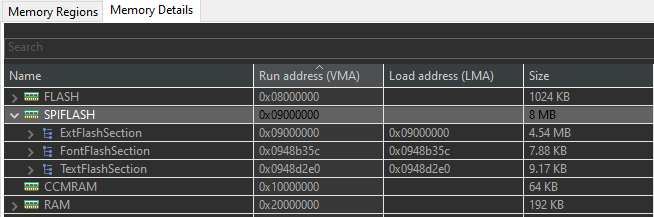

I have W95Q64 flash memory and STM32F429 custom board. I want to load Touhgfx files to external flash memory. For this purpose, firstly I added below declarations into FLASH.id file as;
SPIFLASH    (r)    : ORIGIN = 0x9000000,   LENGTH = 8M
and
ExtFlashSection :
    *(ExtFlashSection ExtFlashSection.*)
    *(.gnu.linkonce.r.*)
    . = ALIGN(0x4);
  } >SPIFLASH
  FontFlashSection :
    *(FontFlashSection FontFlashSection.*)
    . = ALIGN(0x4);
  } >SPIFLASH
  TextFlashSection :
    *(TextFlashSection TextFlashSection.*)
    . = ALIGN(0x4);
  } >SPIFLASH
after compilation in CubeIde, the memory is created as shown below;

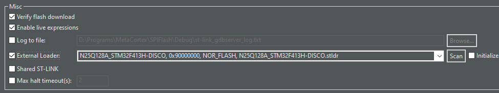

0693W000006Eu2GQAS.pngMy problem is that I dont know how to download all those files to my board. As far as I know, I need to use external loader in debugger section but there is no convenient option in the tab which is exactly match with my configuration.
0693W000006Eu67QAC.pngit will be appreciated if someone explain what to do additionally and explain all procedures step by step.

You'd have to write an external loader suitable for your part and board wiring choices. Not really a paint-by-numbers process.
If you've already coded something to initialize, erase, read and write the memory, you could integrate that into your application, allowing you to detect that the SPI isn't filled, and provide a method to download binary content via UART using say X-MODEM or Y-MODEM type protocol.

This is attached to a SPI bus, it won't be mapped into the STM32's address space.
