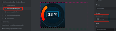

I am trying to copy the TouchGFXDemo1 in TouchGFX Designer.

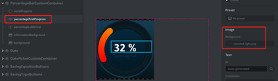

When I add a "text progress", there is a property of Image for the background.
This property always has an initial image, and I do not know how to delete it.
Could someone tell me how to do it?
I want it like this:
Thanks

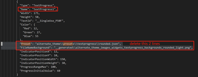

Finally, I found an abnormal solution: delete the property in the .touchgfx file by opening it in text format:
‎2024-04-17 3:08 AM
Hello @Junde ,
Your TouchGFX version seems to be quite old.
In the more recent versions we have removed that feature.
Therefore, the simplest way to solve your problem is to update to a more recent version.
It is always recommended to use the latest version publicly available.
