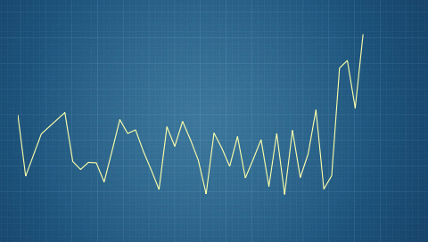

I found the Graph in touchgfx-open-repository-master.How do you create a Graph that's constantly moving, so that it does what an oscilloscope does:grinning_face_with_sweat:

Yes​,To achieve oscilloscope function,I wonder how to update and move graph in real time.
‎2019-07-31 7:26 AM
If you mean scrolling the graph to the left and then updating the pixels on the right, then I have done something similar at a lower level.
What I did was shift the entire window to the left by one pixel i.e by manipulating the contents of the frame-buffer directly. I then added the new pixel to the right of the graph. Produced a nice scrolling effect, was smooth and did't need to erase the existing pixels as shifting the memory did that automatically. Could do multiple graphs as without addin extra overhead.
