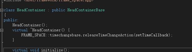

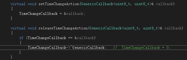

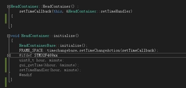

I make a time-display-container and bind callback from RTC wakeup irq.
Set binding operation in time-display-container init function.
Unbinding it in destructor function.
But my unbinding operation does not work.When RTC wakeup irq is calling,it
trigger and show the last screen(which has time-display-container) I had leave.
How can I unbind the callback?
setAction and ReleaseAction

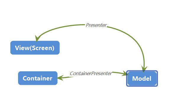

Zbobo.1
0693W00000BbRLYQA3.jpgI would like to make a triggle way like this.
