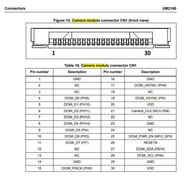

I am doing a project using the STM32L496G-DICOVERY board to capture photos and video, I want to use the OV2640 camera but I don't know if that camera is compatible with that board since the board has a plug and play connector,
You can use OV2640 CMOS sensor with L4 board, but make sure that your camera module embedded the OV2640 is compatible with the camera connector CN1 of 32L496GDISCOVERY.
I advise you to refer to the Table 19. Camera module connector CN1, in the UM2160 and check the pins and configuration.

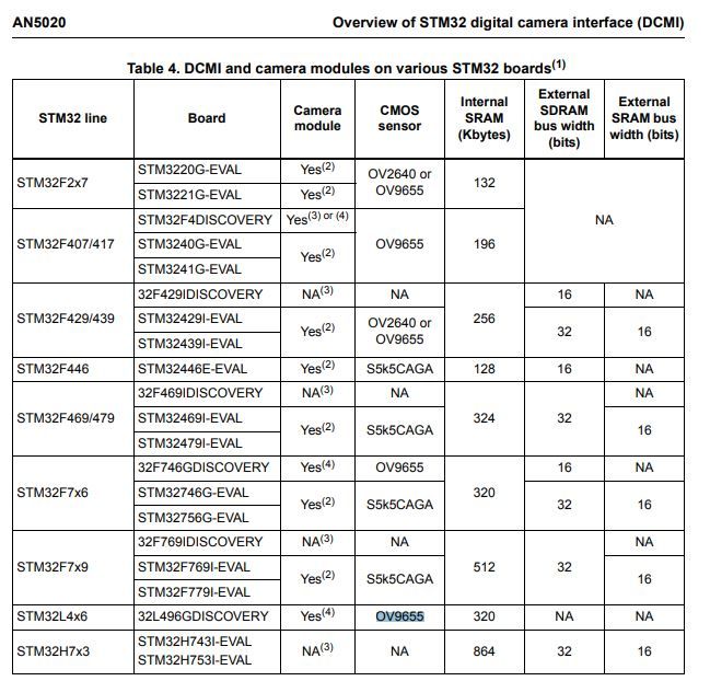

Thanks for your resoonse, I read the datasheet but I bought a OV2640 with FFC conector but it turns out that it has 24 pins and the conector of the STM32L496G_DISCOVERY has 30, so can you recomend me other mudule or a solution for that.
Hi @FTila.1​ ,
You can use the OV9655 CMOS sensor with the STM32F4DISCAM camera module.
I advise you to refer to the table 4 (and note 4) on the AN5020 - page 21.
