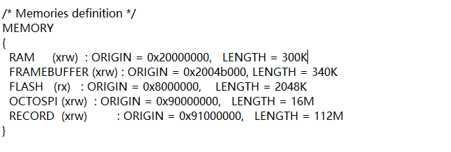

Hello, i hava got a problem with full scrren size controls. Sometimes, there will be a flash line end of the controls. What i suppose to do with this problem?

The only thing I do for framebuffer that I set the address by setFrameBufferStartAddresses() in TouchGFXGeneratedHAL.cpp.
I think this is for the touchgfx framework. So , nothing to do.
What you have in LD linker files? And how IDE ?
When you use CubeIDE then you have file
STM32XXXXXXX_FLASH.ld and for example

your numbers and memory may differ, but when you plan framebuffer in RAM you need change this file or use normal aloccation as for example
uint8_t FB[320*360*3];

0693W000006HHJ3QAO.pngyes, i configured this. And, My IDE is STM32CUBEIDE
Hmm when realy this file is used for compile and flash your project, then i dont understand .
try change framebuffer to 0x20048000
RAM size to LENGTH = 288K

Thank for your suggestions, and i will try this, but why? Seems to be getting smaller.
Only RAM is smaller, because when framebuffer start on 0x20048000
RAM must end here.
Fine, I get it​. Thanks a lot!
