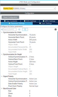

I'm back to the topic. I upgraded to TouchGFX 4.23.0 mainly for SVG images. I checked if the issue persist on older versions of TouchGFX which still have SVG images. I stopped at 4.21.4 and unfortunately artifacts in the font rendering are still in place.
I cannot share with you my whole project (confidential) but I created some sample screen using ST stock images. Below you can find a video and also my configuration you asked about:

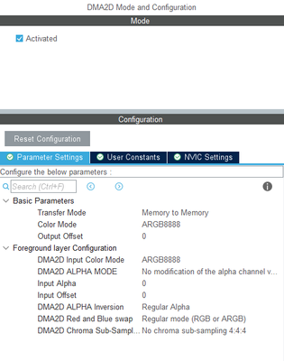

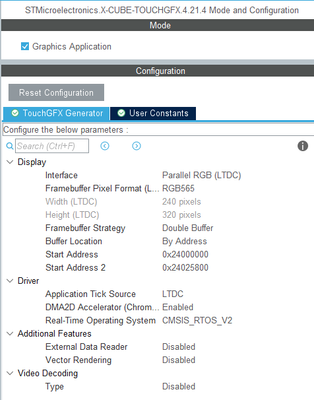

The board is custom. We use parallel RGB LTDC RGB666 to drive the LCD. We also use DMA2D. The configuration of the peripherals:
DMA2D:
LTDC:
TouchGFX:

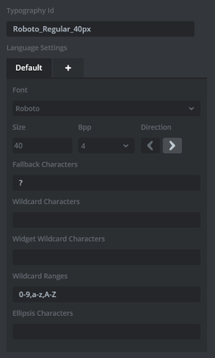

"text settings and typographies":
I attached the video describing my problem and also source code of the screen.

Hello again @ypiotrp ,
Sorry for the delay.
From the pictures you sent everything looks fine (I assume that in the Pixel Format in your Layer Settings in LTDC is set to RGB565). Since the issue is only with fonts (based on your video), I think it might be helpful to change the location of the Fonts and Text in the memory. So, if it is possible, try to put the fonts in internal flash.
Also, could you please send a screenshot of your Text Configuration from Configs (from TouchGFX Designer)?
