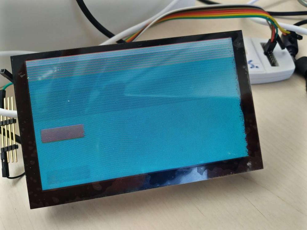

i've got a "low cost" dev board with STM32F429BI SOC and 5inch touch LCD, and i'm praticing with the current CubeIde 1.3.1 / TouchGfx 4.13 CubeMX framework.
i followed the instruction for a new bring-up and they are pretty enlightning! the TouchGfx boys are pretty strong!
Now, i put all the stuff for FMC SDRAM and LTDC proper cfg (scanline and more), when i enabled the LTDC global interrupt i started seeing the light of the first screen in my TouchGfx mockup project.
The issue i'm facing now (before delving more in depth on the touch screen driver as next steps) is about a "flickering" starting to appear some 30 seconds later after program running.. see the video below (complete "idle" framework, Model.cpp tick() is called, empty, nicely..)
it looks to me some kind of "hardware FIFO/DMA" is trashing.. but i'm puzzled because it does NOT happen at start, but at a later time.. and it goes worst along time
i'm just wondering if you have seen something similar before.. and/or have a clue about where to look more in depth.. i'm planning to check the MCU instrumentation binding, just to check "how high is the CPU load".. what do you think?

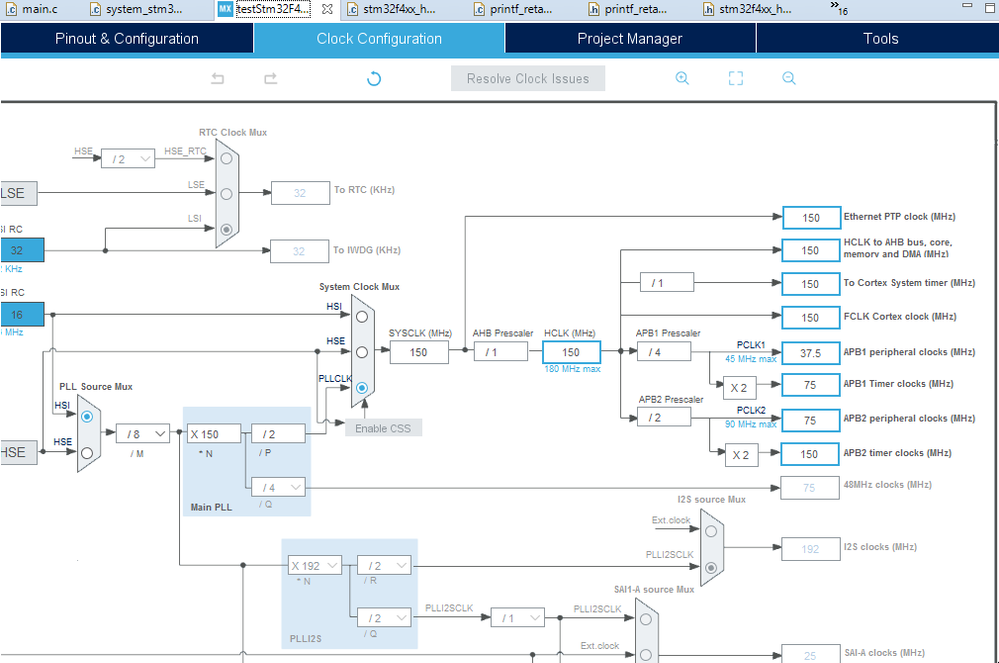

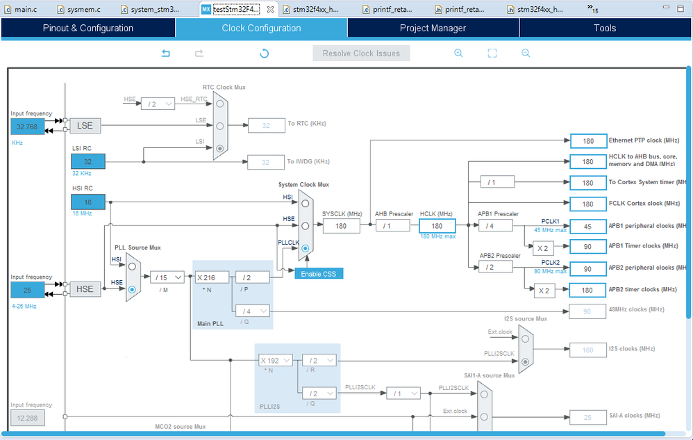

i checked the clock tree, it looks like i'm using the internal HSI (too high RC jittering when SOC warming?) and not the external HSE (a 25MHz crystal..)
when i moved to the HSE, indeed, the flickering is no more..

2020-06-09 1:21 AM
just to add some more info, the clock cfg in the CubeMX prj
and another later short image about artifacts becoming worst.. still running and not stuck, anyway
let me finally add we are talking about a 800x480 display with RGB888 (3 byte) pixels.. so i know it's quite taxing the SDRAM.
i used the SDRAM params from the BSP of the vendor, and it works ok for the first 30 secs, so that's quite puzzling me..
