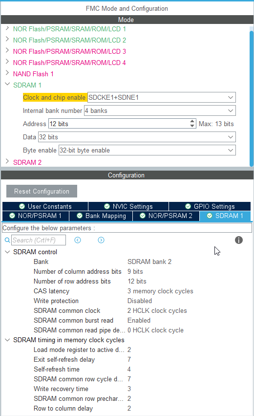

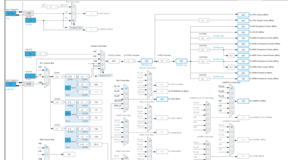

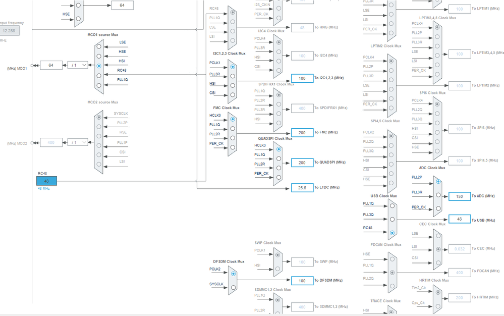

Hello, I have my project based on STM32H753I-EVAL with RGB LCD display and SDRAM.
I'm using DMA2D to render lines with CLUT L8 (Pulling mode). Basically, I process data for one line (one line have 320 pixels), and then execute it 108 times (for height). I'm rendering this 30 times per second. But for some reason, it sometimes render black (so it's blinking) (where data are correct), or it just freeze (since it's polling mode, it's frozen in checking if transfer was finished). After it timeout, it tries once again, until after few seconds it starts work again and then again freeze. I would expect that somewhere in code I have issue, but the exactly same code, used on STM32F429-DISC1, it works absolutely fine.
So it looks like it's not my code problem, but my several concerns are:
1) SDRAM - I tried to verify if SDRAM have correct clock and configuration according to EVAL example, everything looks good
2) Broken DMA IP Core inside H7?
3) Other clock problem
I'm totally out of ideas, since it works correctly on F4. Here is my code, configuration and clock tree.
