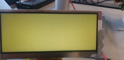

Hello community,
I am using NUCELOH7A3 and a 800x320 display. I could fill the screen, display lines and texts using RGB565 and ARGB8888. Now I wanted to use the L8 forrmat with a LUT.
Using the the DMA2D mode Memory to Memory works fine (array)! But using the mode Register to Memory does not.
BSP_LCD_WritePixel() works fine with the L8 format. But the BSP_LCD_FillRect() that uses DMA2D has some problems.

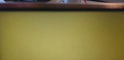

It displays verticle lines, displaying 1 line and skipping 1 line after. So it writes the pixel and skips the one after.
Here is the code.

 Am I missing something? Thanks for your help!
