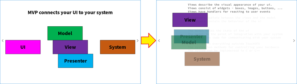

Using TouchGfx 4.14.0, select "Understanding Application Structure" example and run on target (stm32f469i-disco).
It will stack overflow on the 3rd transition:
The cure is to increase stack size from 2048 to 3072 (\TouchGFXProjects\MyApplication_1\Core\Src\main.c, line 69).

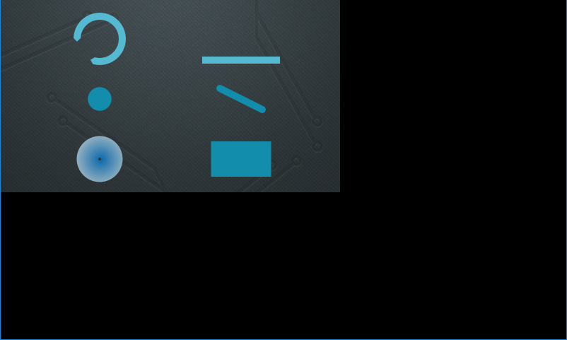

With stm32f469i-disco and TouchGfx 4.14.0:
  • many of the examples don't scale to full screen size (800x480) so result looks odd...
FlexButtonExample\1.1.0\
TextExample\1.1.0\
TextRotateExample\1.1.0\
ModalWindowExample\1.1.0\
LineAndCircleExample\1.1.0\

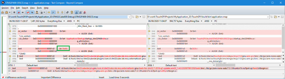

DPant.1
PS: the "black screen" examples work if imported and rebuilt from STM32CubeIDE (Generate Code -> Browse Code -> --\STM32CubeIDE\.project -> Run).
Noticed that resulted STM32CubeIDE\Debug\STM32F469I-DISCO.hex is smaller than the original not-working TouchGFX\build\bin\target.hex and this can be seen in the map too:
