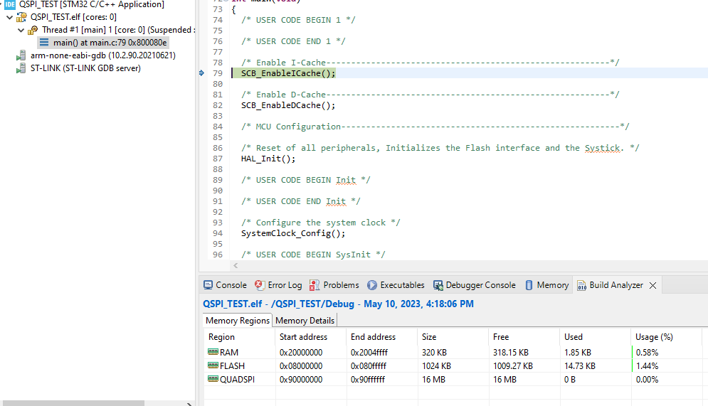

I still have the problem, to give more details, I created a template project using TouchGFX copied code from .ld file about QUADSPI section as show you below and code in MX_QUADSPI_Init function.
MEMORY
RAM (xrw)   : ORIGIN = 0x20000000, LENGTH = 320K
FLASH (rx)   : ORIGIN = 0x8000000, LENGTH = 1024K
QUADSPI (r)  : ORIGIN = 0x90000000, LENGTH = 16M

But checking memory on "Memory details", FontFlashSection and TextFlashSection are still on internal flash.

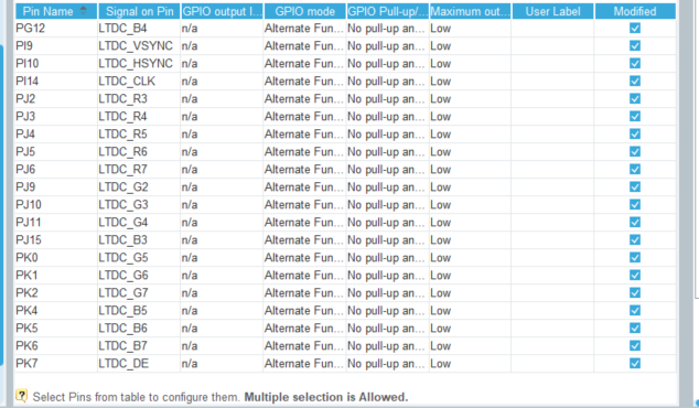

This is my pin configuration
And the pin mentioned on video "PI12"
And Still having black screen on debug.
A pair of things I have saw
* debug gets stuck for a long time on 93% after gets to main waiting for press button run.
* If something is modified and then genereded code; the first lines of configuration on QUADSPI init function are showed.
I hope this information give you a clue of what is wrong with my example project.
