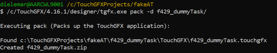

Romain DIELEMAN
I believe you are not in the right folder and should not be using the .touchgfx project in the command but the folder (no need for the / at the end).

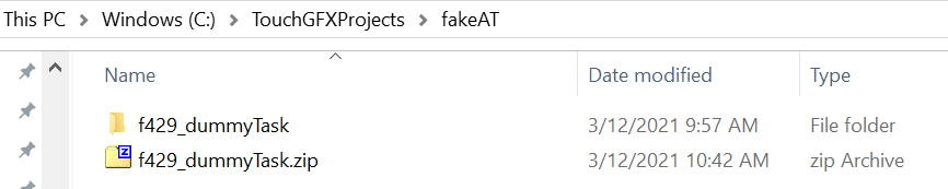

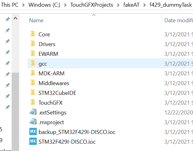

Here is the steps I did for a fake AT of one of my projects on the F429 disco board:
0693W000008wjQbQAI.pngMy folder look like this (zip file was created by the command above):
Out of curiosity, you are working on a custom board. Did you use CubeMX and developed your project similarly to what we do with the application templates for the dev kits like in the following screenshot ?
/Romain

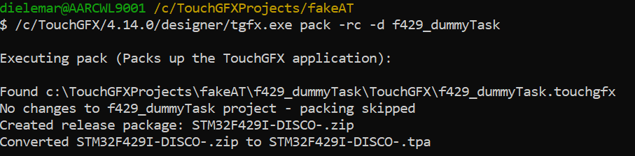

Romain DIELEMAN
I actually met issues creating a tpa (the next step), I do not know if you will face them as well but just in case, what I did to avoid them was to download in addition TouchGFX 4.14 and run the commands from the TouchGFX 4.16.0 environment but using 4.14 in the actual command , so like this:
$ /c/TouchGFX/4.14.0/designer/tgfx.exe pack -d demo/

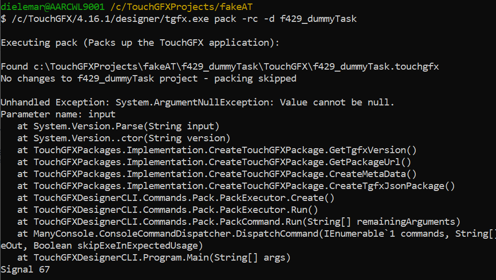

FYI the errors I faced with 16.1 are the followings:
0693W000008wkp3QAA.pngI investigated and could only make it work with TouchGFX 4.14 or older. I informed the team to know how we can fix that and find the source of the issue.

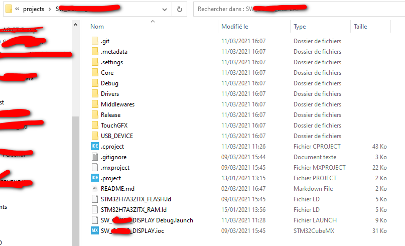

Hi, you're right I messed up with the commands and folders; though before doing that I also tried with the right commands and also got some errors.
My project has been generated by CubeMX, and has the same structure as your:
0693W000008wlfsQAA.png(sorry I blur some infos, forget about the project one in my first post it is not the same as this one, it was just an example from a generated project by TouchGFX with an official demo board)

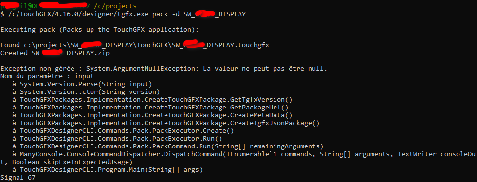

Indeed when I run the proper command with TouchGFX 4.16.0 environment it end up with the same exception:0693W000008wljLQAQ.pngbut the zip file is well created (not the json).

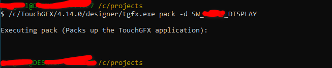

So I installed TouchGFX 4.14.0 and runned the same commands with the TouchGFX 4.16.0 environment as you mentionned in your second post, and it ends up like this :
0693W000008wlksQAA.pngnothing happens
