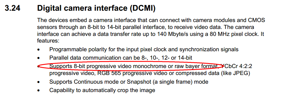

Does STM32H750 DCMI support RAW10bit?
wwang.21
in datasheet, it support Raw 8.

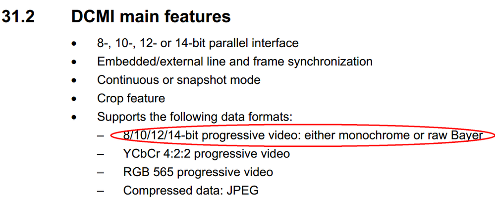

0693W00000Dlhb6QAB.pngin Reference manual(RM0433), it support raw 8/10/12/14 bit.
Has anyone tried the raw10bit ?

Hello @wwang.2​ ,
The Reference Manual is correct.
It Supports: – 8/10/12/14-bit progressive video: either monochrome or raw B.
I have raised the DS typo to our team for fix.
Internal ticket number: 112729 (PS: This is an internal tracking number and is not accessible or usable by customers).
