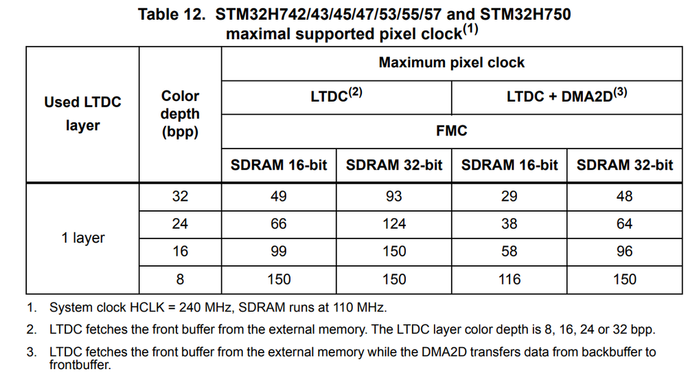

LTDC prebuffers data read appnote about this. 72MHz is little edge try use math
Test lower to 70 68 66 ... Optimize as described in appnote

I don't think it is on the edge, because 100 MHz with 32 bit data interface means a little bit less than 3.2 Gbit/s, if burst mode is used. And 16 bit with 72 MHz needs only 1.1 Gbit/s. And it wouldn't explain why it also happens sometimes with 200 MHz clock, and why it doesn't happen when the CPU is running in an infinite loop. My assumption is that the AXI bus is blocked too long sometimes, which the AXI interconnect matrix QoS configuration should solve, but it didn't.

According to the application note, the highest pixel clock with STM32H757 and SDRAM with 32 bit is 150 MHz, for 16 bit mode. So the 72 MHz I'm using is not on the edge, as expected.
The line length is also a multiple of 128, so it can do all reads with burst reads, says the application note.
But there are some other tips about speculative read access, SDRAM RBURST mode, and cache settings. Will try this next, maybe it solves the problem.

150 is teoretical max. Your bus need space to other work. And if D2DMA is used ...
for 24 bit is max only 64. Try locate code and show here, what produce glitch. For example update text or ... Too some LTDC interrupt driver implementation is buggy usw.
