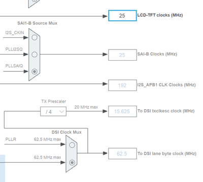

  The lane byte clock is set 62500 Khz
  The pixel clock is set to 27429 Khz

in debuger check values calculated here , too clock ltdc is real 27.429MHz ? And is max DSI speed required?
@Alekseusis correct that the pixel clock has to be provided to the peripheral initialisation as an integer number of KHz. 27429 KHz is the value used in the example provided by STM, but I have also been able to get it to work at a lower speed, and as high as 35000 KHz.
For completeness: the limiting factor of the pixel clock on this dev board seems to the FMC/SDRAM bandwidth - page 26 of AN4861 has some good recommendations on that topic.
I ask if in clock config you have this numbers as in code
but we can end this conversation with explain. This display work ok with portrait refresh because controller NT reads GRAM and shows data on display filled in memory from video mode traffic. Tearing here may occur but is line type on place where data is read and writed same time (protected with some buffer or GRAM bidi). But when GRAM is filled in landscape order and read in portrait tearing is angle line type diagonal and visible (protect rw not work here)
