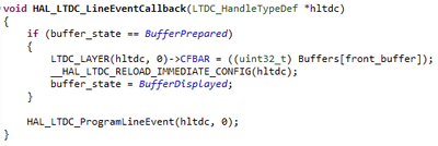

I have spent a very long time removing the BSP initialisation calls from the LCD_DSI_VideoMode_DoubleBuffering example on STM32F469I-DISCO, however it behaves exactly the same using the "stock" example and with my modifications. I am not using TouchGFX.
The symptom is a consistent diagonal tear in a fixed location on my landscape configured display regardless of where the region of the screen I am editing is. Naturally, if the region I'm editing doesn't cross the diagonal, the tear isn't visible. Slow mo video of issue is attached.
In both the example and my modified code, the screen is waiting on HAL_LTDC_LineEventCallback to switch to a new buffer like so:
In my modified code as shown above, Buffers[front_buffer] is written to (using DMA2D) while the state machine is at the state before BufferPrepared, and then the state machine moves on to BufferPrepared 200ms later (same behaviour when this is much higher). 200ms allows the DMA2D plenty of time to complete, so when the interrupt above fires with the buffer state correctly set the data should be stable and unchanging.
So in summary, I have 2 buffers in SDRAM. The DMA2D is only ever writing to the one that the LTDC is not reading. And there's a significant enough delay between the DMA2D operation and the LTDC swapping buffers that the DMA2D must have completed in time. So why does the display end up displaying half (not exactly half, but whatever) of the old buffer and half of the new buffer, split by a diagonal line?

For what it's worth, I got a reply from ST on my engineering support ticket that @Tesla DeLorean recommended I submit. They don't think this is a configuration issue, and that the only landscape option with this LCD is the partial refresh command-mode approach (which I note does improve performance, but as they said, does not completely eliminate tearing effects, only helps). Unfortunately command-mode isn't an option for me with my current project aspirations. See full reply:
LCD screen on STM32F469-DISCO board is not adapted for landscape mode. It will scan vertically (horizontal scanning is not available), This is why you have diagonal tearing effect when configured in landscape mode.
One solution we would recommend is to used command mode partial refresh strategy, this will help to avoid tearing effect.
You can refer to example available in STM32CubeFW_F4 package available also on github.com: https://github.com/STMicroelectronics/STM32CubeF4/tree/master/Projects/STM32469I-Discovery/Examples/LCD_DSI/LCD_DSI_CmdMode_PartialRefresh
Thanks. Tried the pattern generator and ended up with the same thing. So testing LTDC etc is pointless.
As @Richard-CRT mentioned, the display "is not adapted for landscape mode" (but come on, the same display is used with at least THREE boards and there's a double buffer video mode example project created specially for these boards! How come!).
I'm still curious how it could be "adapted" and why the display IC allows to change orientation whereas there's an obvious tearing effect if we do such a change.
When pattern gen show same , you locate issue to chip and DSI config. For example my used displays for change config require around 70 changes in display registers...
And when i good rememmber 469 disco have many releases with around 3 different displays ...
Examples provided isnt guarant 100% working...
You are right, the issue is located but I can't see any option not for chip nor for DSI to change. That display chip (NT35510) requires only 3 registers to be updated (MADCTL, CASET and RASET; or even one if the latter two are equal) to change orientation.
