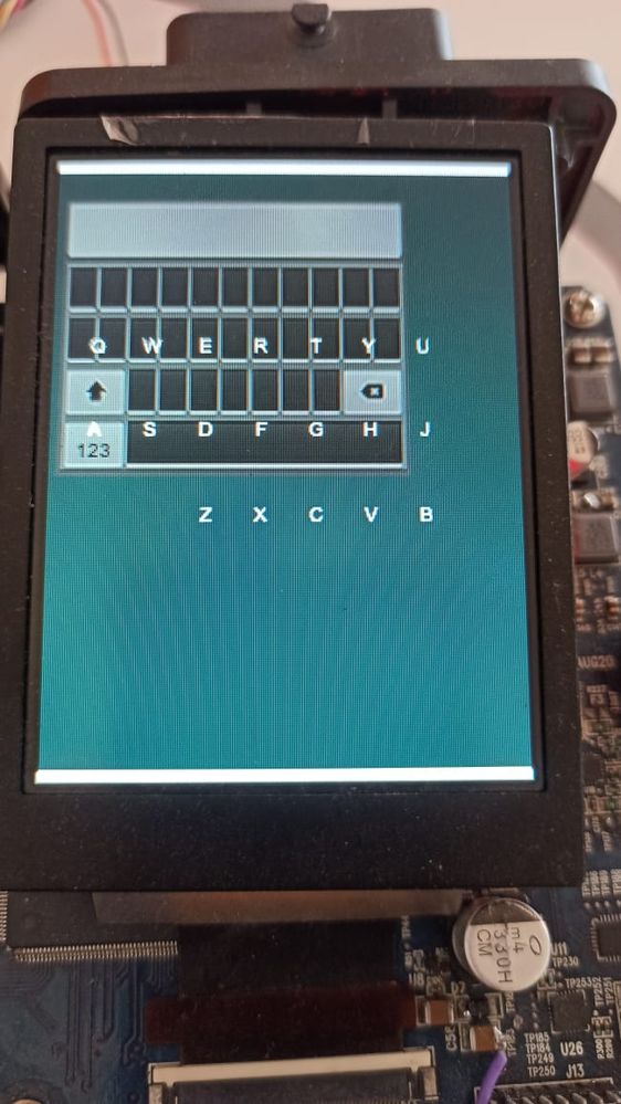

hi team,
Shown below images then you will get known my problem
how to adjust keywords to the keyboards

Could you share how you implemented the keyboard ? Since the keys are all shifted the same way you would need to verify what they use as origin for their position.
/Romain

thanks for replying ,
problem was resolved by changing keysbuffer values
