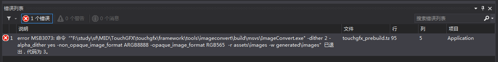

Use cubemx to generate touchgfx, open vs file compilation, error occurs
Please check if the .touchgfx file contains the following command at PostGenerateCommand
touchgfx update_project --project-file=simulator/msvs/Application.vcxproj
This will update the MSVS project with the modified TouchGFX files
/Anders

Hi @lxw​,
TouchGFX Designer needs to be executed before running the MSVS simulator.
This will populate the TouchGFX project with the needed files in order to run the simulator.
/Anders
Yes, I first used cubemx to generate the MDK project, then started designer to generate the code through cubemx.Then use vs to open MSVS, and compile to prompt the question.
/Anders
