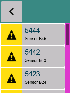

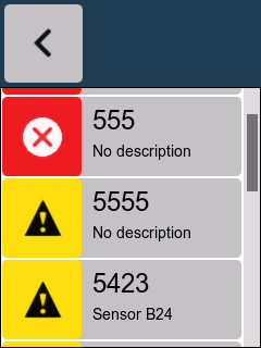

I have same issue. I'm using custom board with STM32F767 mcu, display color depth 16 bit, L8 image formats and IDE Keil uVision5. Colors in the pictures are ok. Problem is with colors got by function getColorFromRGB(r, g, b). For example color (32, 60, 82) was changed to (57, 137, 131) (these values were taken from attached "frame buffer screenshots").
TouchGFX 4.16:
0693W00000JNQ2PQAX.pngTouchGFX 4.18.1:

After some digging in the code I found something which is corresponding with @LMath.2​  answer. In older version of Color.hpp file was function getColorFrom24BitRGB dependent on selected lcd color depth:
static colortype getColorFrom24BitRGB(uint8_t red, uint8_t green, uint8_t blue)
    assert(HAL::getInstance() && "Cannot set color before HAL is initialized");
    return HAL::lcd().getColorFrom24BitRGB(red, green, blue);
After upgrade to version 4.18.1 function getColorFromRGB(r,g,b) is used and its implementation is following:
FORCE_INLINE_FUNCTION static colortype getColorFromRGB(uint8_t red, uint8_t green, uint8_t blue)
    return 0xFF000000 | (red << 16) | (green << 8) | (blue);
It is obvious that this implementation is independent on selected color depth. Maybe value should be recalculated somewhere deeper in the library core. Am I right? Because in my case it is not working and I'm not sure if modifying of getColorFromRGB function Color.hpp will not lead to other problems.
