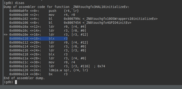

This causes a problem where during touch gfx initialization, hal.initialize() fails 4 instructions after returning from touchgfx GPIO init.
Since the source code for HAL initialize is inside the compiled library, I am not able to debug why zero (0x0) is copied to the r3 register through this instruction.
ldr r3,[r3,#12] // copies zero to r3r3 Memory address at the time of ldr instruction:
resulting in a hard fault when branching the r3 register
blx r3

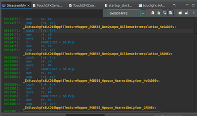

Ok, but what's the fault and registers
What call back is at 0x08014FF2 ?

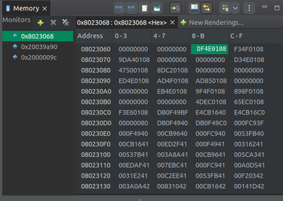

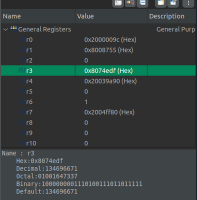

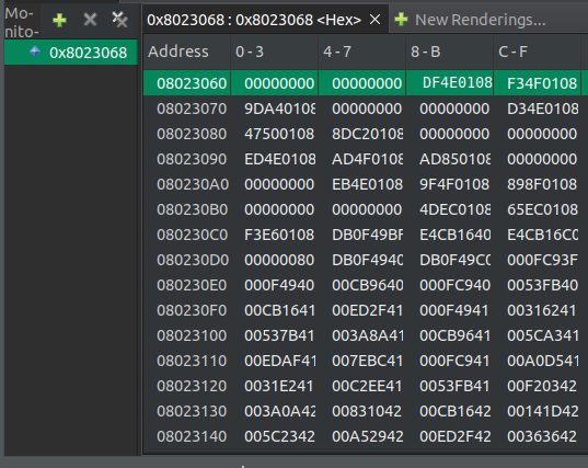

@Tesla DeLorean This operation results in a hard fault, because r3 will get populated with the address 0x0 and:
blx r3is an invalid instruction @ 0x0 .

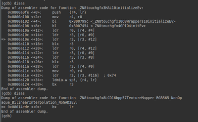

To answer your second question, the disassembly returns the following for 0x08014FF2:
I tried manually modifying the assembly instruction results:
=> 0x0800a10e <+16>: ldr r3, [r3, #12]Above instruction, returned 0x0 to r3. Instead, I copied the value I expected r3 to be populated with (found it by looking at the memory):
After manually populating that address to r3 and stepping once it resolved to this function:
"touchgfx LCD16bpp TextureMapper RGB565 NonOpaque Bilinear Interpolation NoGAD"
I'm not sure if that's the correct function that needs to be called. I wonder if there are further manual changes needed to have touch gfx use the correct function calls to render for 8bpp.
