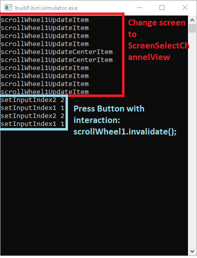

I expect calling function "scrollWheel1UpdateItem " by pressing the button but touchgfx_printf shows it doesn't run:0693W00000KbdWjQAJ.pngIn Red section we see scrollWheel1UpdateItem and scrollWheel1UpdateCenterItem are called when I change the screen to ScreenSelectChannel. But pressing buttons doesn't call those functions.

Ok then before invalidate add
scrollWheel1.itemChanged(1);
scrollWheel1.itemChanged(2);
scrollWheel1.itemChanged(3);
Oh, Yes it works.
