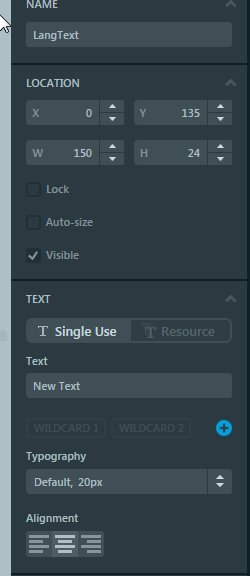

Central text alignment doesn't work
EEuge
Senior
void SmallFlag_Container::SetLanguage(Bitmap icon, TEXTS lang)
    FlagImage.setBitmap(icon);
	  LangText.setTypedText(TypedText(lang));
	//  LangText.resizeToCurrentTextWithAlignment();
 		LangText.invalidate();
In TouchGFX all is right
but in real life text is always aligned at left....
How to fix?

I use this
	textArea1.setWildcard(textArea1Buffer);
	textArea1.invalidate();
	textArea1.resizeToCurrentTextWithAlignment();
and Center need be set in texts.xls or screen Texts in designer
