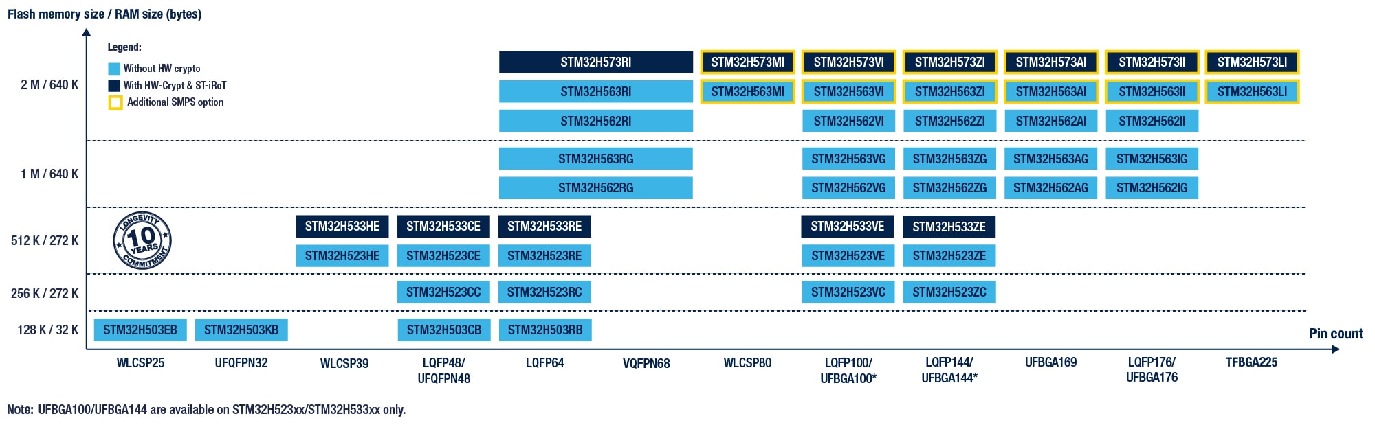

It seems that the maximum memory for the STM32H523cc is 256Kb of flash:
Perhaps the non-secure and secure actually use the same physical memory but the address is different based on if you set it as secure or not?

I think so too. So I need to replace it with a larger non-flash memory chip.
Hello @XiaoenLee ,
I don't understand what you want to replace.
Perhaps you could use the STM32H523ce which only difference seem to be the memory size. Perhaps the change is easy to do or try to optimize your code to fit in 256Kb.
