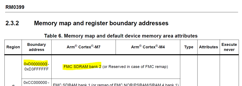

Also, I saw in some example that the LCD buffer is mapped to an address defined at 0xD0000000 but I can't find anywere how this address is configured ? to which chip is it mapped ? there is so much code that I don't know where to start.

Information like that is in the reference manual:
Not sure about the LCD issues, it is not typical that examples don't work correctly.

0xD0000000 SDRAM BANK2​
