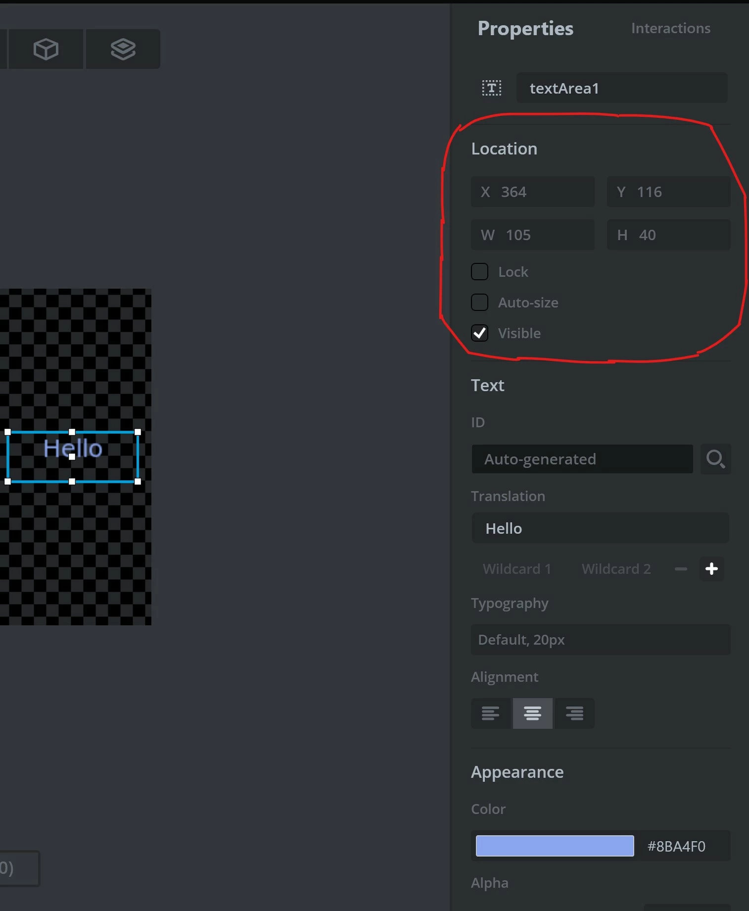

Hello @ArthurStone ,
Consider using static size for your Text Area and give it a size large enough to accommodate the text. You can specify the size your self through the designer by unchecking Auto-size.
 I hope this helps you
