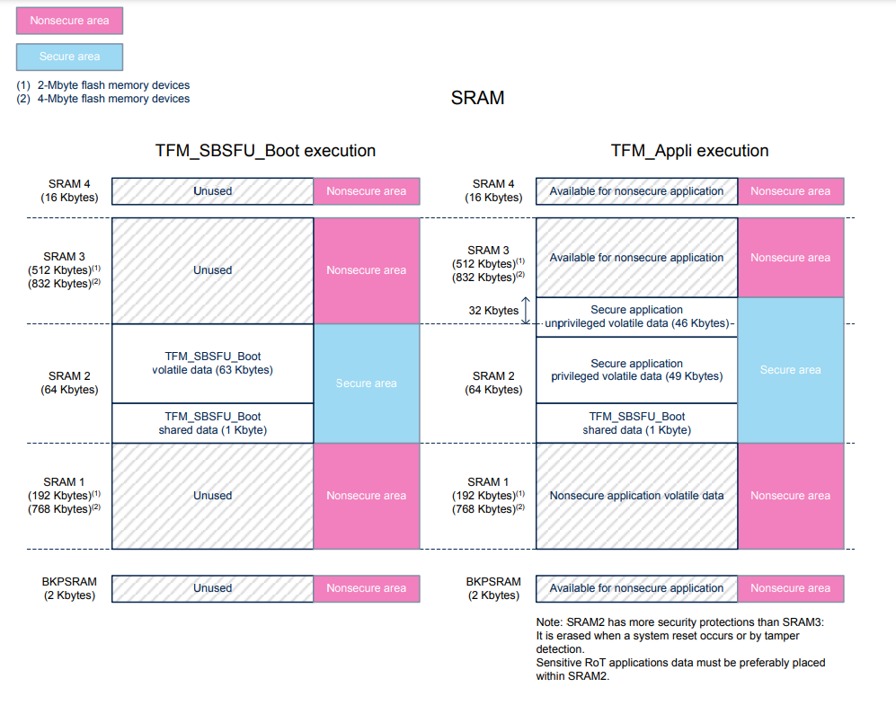

Ok, but I am afraid the TF-M RAM is also erased.
The UM indicates:
"Protected SRAM2: SRAM2 is automatically protected against intrusion once the system is configured in RDP level 1. SRAM2 content is erased as soon as an intrusion is detected. Moreover, SRAM2 content can be write protected (content is frozen but can be read) until the next reset by activating the lock bit. In the TFM application example, the system has been configured to use the protected SRAM2 to share and to freeze initial attestation information between the TFM_SBSFU_Boot application and the secure application."
And the layout is like this according to the UM:
So, I am afraid that anyway your application cannot work properly as the SRAM2 is erased and locked.
Fred

ZKRAC.1
Hi @Fred​,
Thank you for your answer, So it's a hardware configuration that the SRAM2 is protected against intrusion and the content is erased or blocked, which block the secure application !? I understand why it doesn't make any sense to remove the RESET in Error_Handler() because the SRAM2 is erased or blocked, but I don't understand why SBSFU should be able to boot ?
