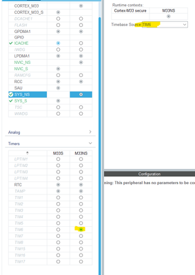

Hi, I've created a project in STM32CubeIDE 1.14.1 for the Discovery board B-U585I-IOT02A with TrustZone enabled. Unfortunately, I'm unable to select any of the TIM timers as the SYS_NS and SYS time source. They are disabled with the following message: "TIM6 disabled: This IP instance is already used or no context is selected."
However, I activated the TIM6 timer with a Non-secure context enabled.
Thanks in advance for your help!

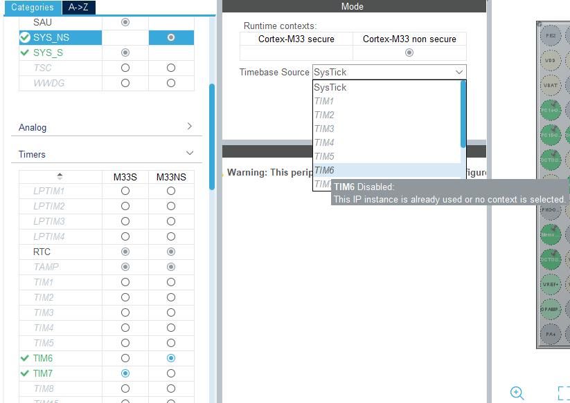

you need to assign the TIM6 to the NS world in timers to be able to select it as timebase.
Here is a screenshot illustrating this:

@STea thanks for your rapid response. But as you can see on the screenshot that I provided, TIM6 is already assigned to M33NS, but it is grayed out when I try to select it as a Timebase Source for SYS_NS, with the following error being displayed: "TIM6 disabled: This IP instance is already used or no context is selected."

Yes, thank you. I updated the CubeMX version from 6.10 to 6.11.1
Here is one of the release notes I've read in the new version when updating:
  • An error occurs when switching the timebase source from SysTick to a timer for the STM32C0 series
Meaning that it was a problem related to the version 6.10. Now the problem is solved in this new version.
