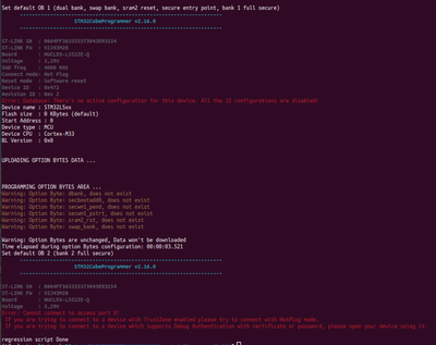

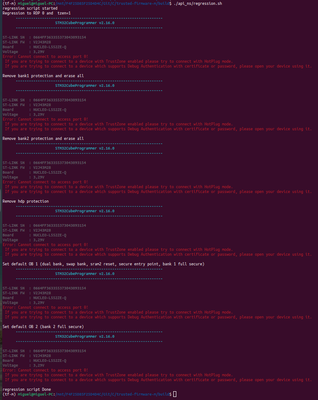

I followed this tutorial to add an example secure partition in TF-M ( https://tf-m-user-guide.trustedfirmware.org/integration_guide/services/tfm_secure_partition_addition.html ) and then followed these instructions to flash the application to my Nucleo-L552ZE-Q board ( https://tf-m-user-guide.trustedfirmware.org/platform/stm/common/stm32l5xx/readme.html ). However, the script regression.sh returned the error:
Error: Cannot connect to access port 0!
If you are trying to connect to a device with TrustZone enabled please try to connect with HotPlug mode.
If you are trying to connect to a device which supports Debug Authentication with certificate or password, please open your device using it.
After this, I am unable to connect my board STM32Cube Programmer or to flash any application using Keil MDK ARM, CubeIDE, etc. The same error is returned every time. Before I runned the regression.sh script, the board was working as expected and I was able to flash simple applications (non using TF-M) to the board. Does someone know how can I fix this problem?
Here is the configuration I have in STM32Cube Programmer:

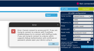

AScha.3
May 20, 2024
try connect :
mode : under reset
reset : hardware
Then try to delete your "bad" settings, maybe full flash erase and set option bytes ...

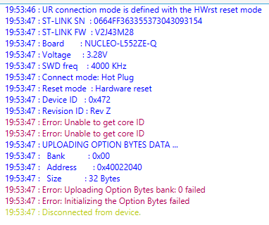

Thanks for the quick reply. I still can not connect:
AScha.3
May 20, 2024
It tells : try Hot plug mode...try.

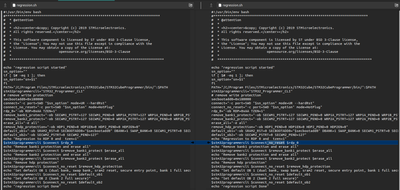

First, you may have issues running TFM on STM32L5 Nucleo as it is running on stm32l562e_dk
Also, the opeion "--hardRst" at line 24 of regression.sh script is not supported in latest version of STM32CubeProgrammer and associated calls are failing. So, please remove this option.
Also did you update the STLink firmware?

As long as I know, the TF-M offers support for the Nucleo-L552ZE-Q platform. The TF-M filesystem have the files for the configuration of this platform under /platform/ext/target/stm/nucleo_l552ze_q and I have specified the platform in the cmake command that compiles my application:
cmake .. -DTFM_PLATFORM=stm/nucleo_l552ze_q -DTFM_PARTITION_PRIVATE_ANN=ON -DCMAKE_BUILD_TYPE=Debug -DCONFIG_TFM_SPM_BACKEND=IPC -DTFM_TOOLCHAIN_FILE=../toolchain_GNUARM.cmake -G"Unix Makefiles"
 Regarding the second point, removing the option --hrdRst resulted in a different output.

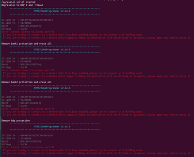

With the option --hrdRst, the regression.sh script returns:
Without --hrdRst, it returns:

well I'm afraid there is no solution to recover the board.
I will try to find time to have a look to this setup and understand what could have happen.
I would suggest next time to start your test by disabling the security protections activation in the secure boot to check everything is working fine. This will avoid the risk to brick your board.

Hello @MCost.4 and @Jeff Tenney ,
I tried to reproduce your issue and couldn't brick my L5 Nucleo board.
What I can tell is that this --hardRst option must be removed from the script (line 24).
The consequence of this option is that at least 2nd and 3rd programmer commands will not work properly.
I'm still not sure how it is possible to end-up in such situation. Normally RDP in all TFM configurations is not activated in development mode which is the default configuration. And as long as RDP is not enabled you should have issue (at least for the L5 case)
For STM32U5 case, if RDP is set the regression script will not do anything because it tries to connect under reset which is not possible once RDP is enabled. And other commands in hotplug mode have no impact when RDP Level 1 is set.
So I have no clue how you could end up in such situation
