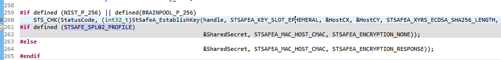

I have successfully run the Establish_Secret demo project, it shows ephemeral key usage:

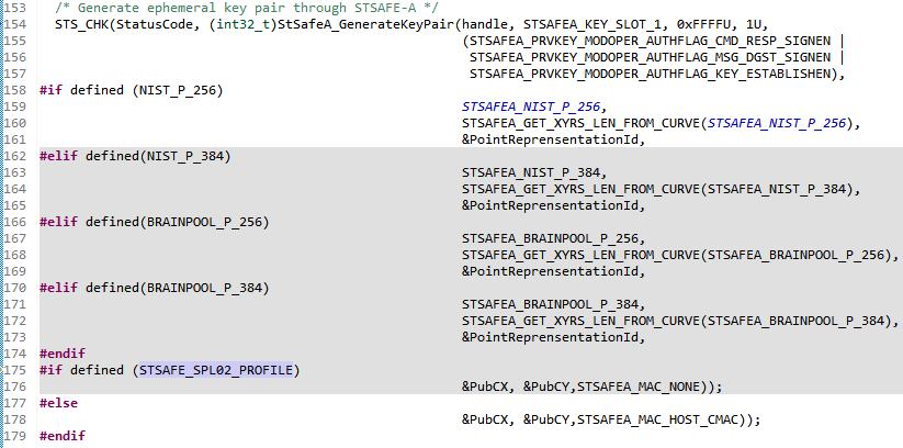

As I need the TPM's private key to survive the power cycle, I replace the ephemeral slot with the static slot 1, also on StSafeA_GenerateKeyPair call:

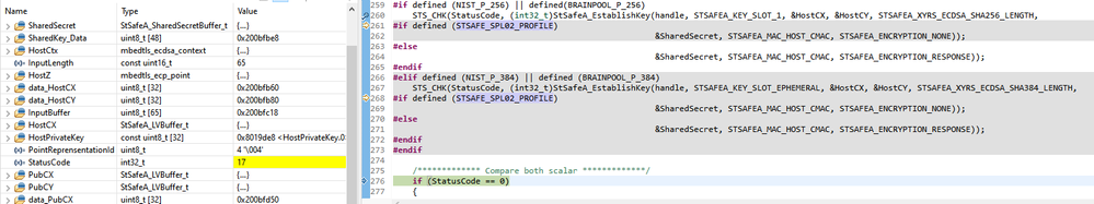

The call to StSafeA_EstablishKey then fails with code 17 (STSAFEA_UNSATISFIED_ACCESS_CONDITION):

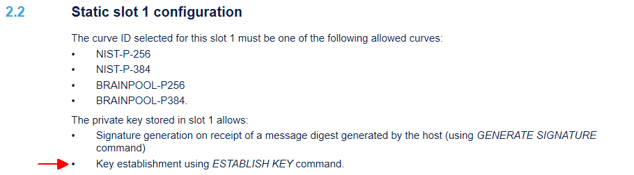

Why does it fail? The documentation for STSAFE A110 clearly states that this feature is supported for slot 1 (document dm00675324):

Hi @FrankT​ ,
Thanks for the interest in STSAFE-A110 solution.
To use the private key 1 for ECDH, you need to configure the slot parameters first as the default value is signature generation only.
Be aware that this configuration is a one-time operation and manage the mode of operation and the key generation authentication at the same time.
Therefore you need to be sure to define the correct key usage scheme before changing these parameters.
I have added an command example in my mbedtls_example.c in attachment.
You can have a look at the STSAFEA_ConfigureKey() command that manage the configuration for you.
In the command comments, you will find the different configuration option.
