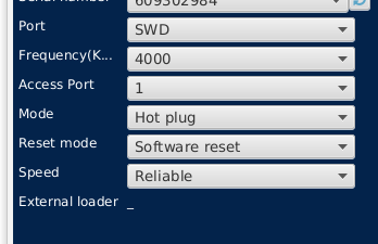

I was able to generate the obk file and to transition the device to provisioning state:

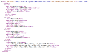

This my xml file and the current product state:

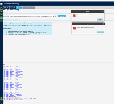

But when trying to provision the obk file, i got this error:
Do you know what could be the problem and how to recover from this state and provision the device ?

Hello @aco990 ,
Please, follow the instructions on our Security Wiki.
There you may find the specific steps for the STM32H573.
The procedures presented in the mentioned article works only for the STM32H563.
Security:How to start with DA access on STM32H573 and H563-TrustZone disabled - stm32mcu - stm32mcu
Hope it helps!
