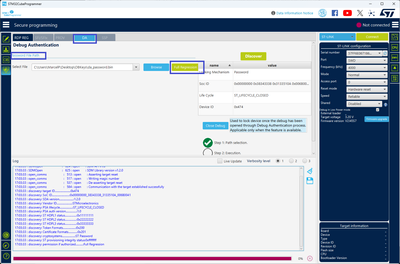

did you actually Check that your device is in fact in OPEN state after the regression?
I am using the CubeProgrammer v2.20 for an STM32H503 now and the regression is NOT working for me.
I use this password file with a 16byte test password:
The CubeProgrammer signals that the "Debug opened successfully", but the target is still in CLOSED state.

MarcelP
Thanks for trying to help me.
No really I think im doing it right. Im in the password Debug-Authentication dialog and i am pointing to my password file, as stated in the dialog hint. My controller is in CLOSED state and the regression will not work.
In my case, I never performed a successful regression in the GUI when I was trying that due to the bug. After that I just used CLI commands as it is easier in production anyway.

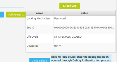

After that, performing the discovery command again still shows my chip as CLOSED:

MarcelP
Ok, I successfully performed a regression now. The problem was with my password file.
This was my original password file:
But I saw in the ROT_Provisioning example Project from the STM32H5 BSP, that there was a bit missing in the header of my file (see the 0x80 at position 3).
This is the password file now that works.
With this, I could successfully perform a regression with the GUI STM32CubeProgrammer.

Now I'm having similar issue. I followed the guide https://wiki.st.com/stm32mcu/wiki/Security:How_to_start_with_DA_access_on_STM32H503 guiding me to "Make a first trial setting the product in PROVISIONED state: "
And now it seems I cannot get out of Provisional state. I tried regression.bat and CubeProgrammer GUI pointing at my da_password.bin, but every time I try to connect I get the error
SDMAuthenticate : 1382 : client : Error parsing password file ()
The first 4 bytes in the file are 0x00, 0x00, 0x00, 0x80 as MarcelP  shows it should be?
Any other things I should try out before dumping my Nucleo board in the trash?
