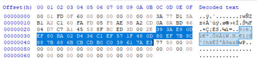

  3. Open ConfigWithCertificate.obk  with Hex Editor and take 32 bytes from 0x2C offset: hash in OBKhash in OBK
     this is a hash, stored in stm32 chip.

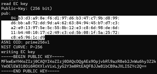

  4. run shell command openssl ec -pubin -in Da_root_key_pub.pem -textKonstantin_Z_0-1758201323813.png,
    You will see 65 bytes of the public key. We need the 64 bytes from the second byte only. Copy them to your Hex Editor and give a filename password.bin
  5. Check the SHA-256 hash of this file. Here, for example. The hash should be the same as one at the 3rd stage.
  6. Add the header "00 00 00 80 40 00 00 00" to your password.bin
  7. Use this password.bin with the DA autentification and make a full regression.
  8. Done!
