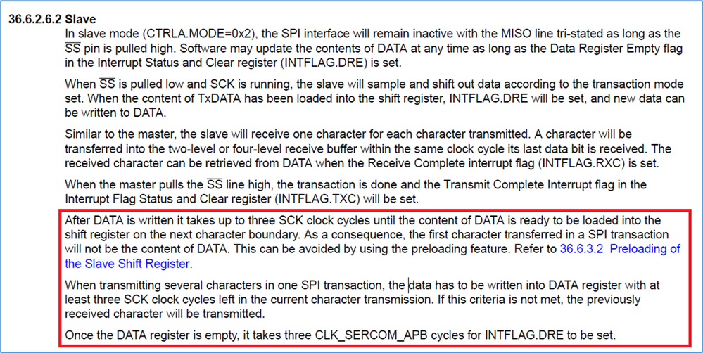

Hi, in Controller of microchip, below is mentioned for SPI
so wanted to know, this type of delay is thr in ST controllers, in specific? or in any series constraints for SPI, if so please let me know, it will help for shortlisting of MCUs
here we have a ready data to send before the MCU is ready to receive, so we need a minimal delay nearly in some uS. as per the requirements. can that be acheivable?
