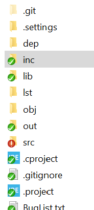

Hi Frantz,
I purchased an STMicro L4 board and successfully followed the tutorials “1 – 10 Security Part6 - STM32 security ecosystem without any problems.�?
I have a large bare metal project (50+ source and header files which compiles without errors) that I would like to secure using SBSFU and flash to a “STM32F769I-Discovery�? target using a 2_Images approach.
I am able to run “00_StartTeraTermM7.bat�?, “00_ResetM7Target.bat�? and “01_Flash_SBSFU_UserApp.bat�? and can navigate through the numbered options in Tera Term without any problems.
I have been editing the paths in the 02_01_Postbuild_SimpleAppV1.bat to fit my directory structure and also altering my directory structure to try to match the required paths in the script as you previously suggested but this does not currently produce a *.bin or *.sfb output as the script fails to find my *.elf file.
Importing the project using STM32CubeMX to produce the correct directory structure is not possible because we have HAL files that we can’t risk being overwritten.
This is our project directory structure.
I am unsure of the best way to alter / setup the project to work with SBSFU.
I have downloaded “STM32CubeExpansion_SBSFU_V2.5.0�?.
Is it best to place this folder in the project directory?
Is it best to edit the ‘postbuild’ script to point to the relevant directories (e.g. SBSFUBootLoader) or place the required directories in a specific location, or a mix of both strategies?
The SimpleApp project does not appear to reference ‘2_Images_SBSFU’, ‘2_Images_SECoreBin’ or ‘2_Images_UserApp.
Are the binaries created in ‘2_Images_UserApp’ concatenated with the new firmware build using the Postbuild script?
How would you setup the project?
Any help will be very much appreciated.
Thanks
