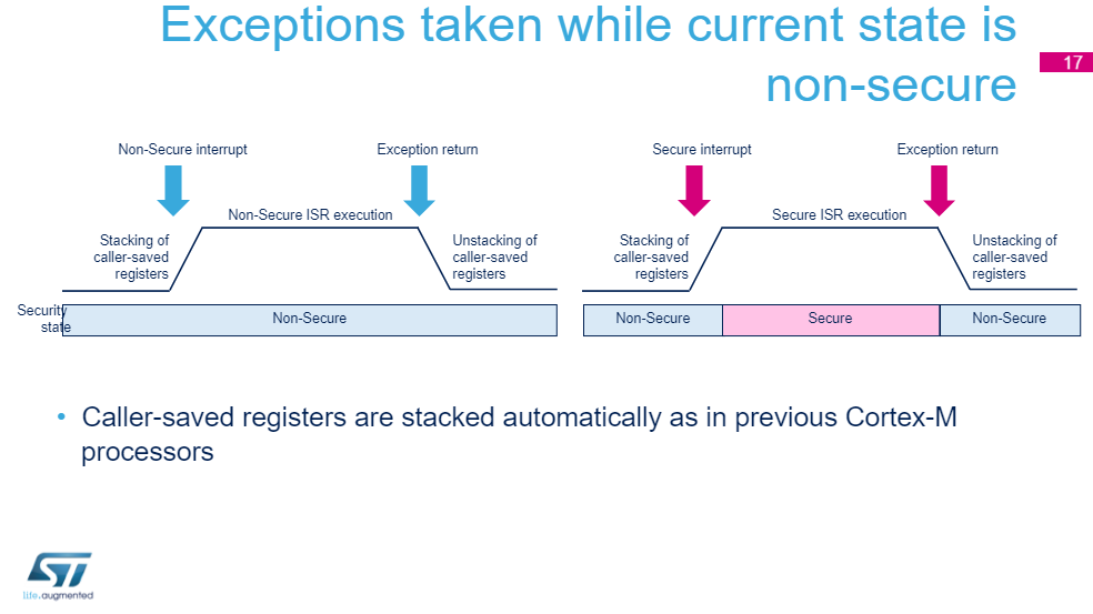

  • First case : Exceptions taken while current state is non-secure
When an interrupt is taken while the current security state is non-secure and the interrupt source is non-secure, the sequence is the same as V7-M exception mechanism. The caller-saved registers are automatically saved when exception is taken and automatically restored upon execution of the exception return instruction. The Interrupt Service Routine is executed in non-secure state. When an interrupt is taken while the current security state is non-secure and the interrupt source is secure, the unique difference is that the Interrupt Service Routine is executed in secure state. Caller-saved registers are pushed and popped to / from the non-secure stack.

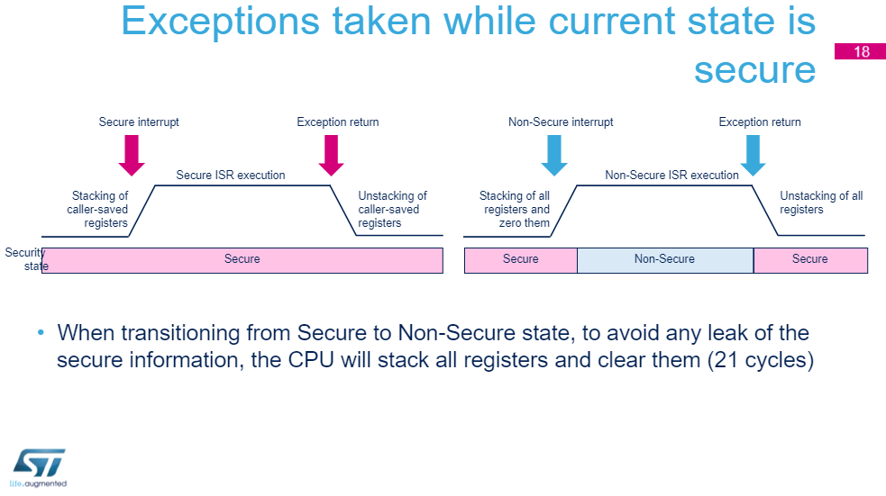

  • Second case :Exceptions taken while current state is secure
_legacyfs_online_stmicro_images_0693W00000dDQ9uQAG.pngWhen an interrupt is taken while the current security state is secure and the interrupt source is secure, the sequence is the same as V7-M exception mechanism. The caller-saved registers are automatically saved when exception is taken and automatically restored upon execution of the exception return instruction. The Interrupt Service Routine (ISR) is executed in secure state. When an interrupt is taken while the current security state is secure and the interrupt source is non-secure, then a risk of register contents leak exists, because the general-purpose registers contain secure data. Therefore the microcode in charge of register stacking saves all registers into the secure stack and then writes zero to all of them, prior to starting the execution of the non-secure ISR. 21 clock cycles are needed to achieve this register stacking. Unstacking is performed from the secure stack and restores the contents of all general purpose registers.

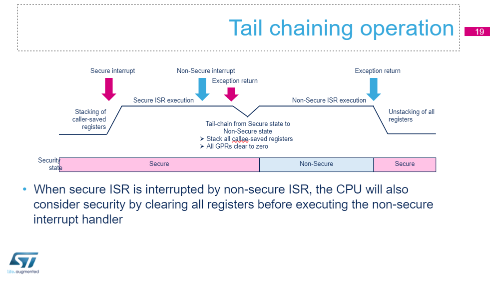

  • Third case : Tail chaining operation
_legacyfs_online_stmicro_images_0693W00000dDQA4QAO.pngThis sequence details the tail-chaining from a secure interrupt service routine to a non-secure interrupt service routine. At the beginning, the processor runs in secure state, while a secure interrupt is requested. The microcode saves to the secure stack the caller-saved registers. Then a non-secure interrupt is requested. When the exception return instruction is executed at the end of the secure ISR, the microcode in charge of tail-chaining automatically saves to the secure stack all called-saved registers, so that all general purpose registers (GPR) have been saved. All GPRs are automatically cleared to zero prior to starting the execution of the non-secure interrupt service routine. At the end, when the exception return instruction is executed, the microcode restores all GPRs from the secure stack before resuming the execution of the secure application.
