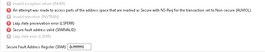

How to properly configure STM32U585 to use DMA in secure mode (TZEN = 1) to send data from internal Flash (non secure zone) to Hash (in secure mode)?
Aurelien1
I want to know a properly way do to that.
If i use standard configuration I run hard fault as soon as DMA start (linklist mode) (HAL_HASHEx_SHA256_Start_DMA).
I put Fault Analyser details
0693W00000YAa7YQAT.pngSource/Destination secure bit are set before calling this function.
Can someone help me?
Thanks
Have a good day.
Aurélien

Hi @Aurelien​,
the DMA channel has to be configured secure, then for the transfer itself the SSEC attribute must be zero and DSEC attribute set to 1.
BR,
J
