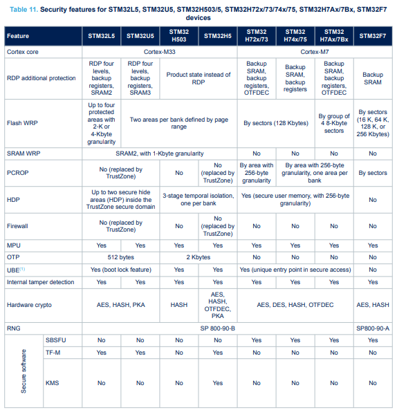

I was searching for the security features of STM32F769I - DISCO and came to know that only STM32F77x has CRYP and HASH in the STM32F7xx series.
Do STM32F769I - DISCO really have security features? If so, can you provide a relevant document regarding to the security features of STM32F769I - DISCO board?

Hi @MdFayaz​ ,
Please refer to table 11. Security features for STM32L5, STM32U5, STM32H503/5, STM32H72x/73/74x/75, STM32H7Ax/7Bx, STM32F7 devices in AN5156.
_legacyfs_online_stmicro_images_0693W00000bhvoqQAA.pngI hope this help you!

Hello @MdFayaz​  and welcome to Community :) ,
The STM32F769 MCU doesn't have a cryptography like STM32F77xx.
I recommend you AN5156 Introduction to STM32 microcontrollers security.
Kaouthar
Thanks @KDJEM.1​ for your instant reply.
Do STM32F769I - DISCO have any basic security feature or is it possible to add security features?

Hi @MdFayaz​ ,
