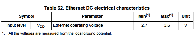

For the Ethernet:
For USB:
The USB is functional, including its internal transceiver, only for VDD >= 2.7 Volts.
For VDD < 2.7 V, we are not guaranteeing that our internal transceiver is functional at all temperature and process variation.
However, to be compliant with USB specification, you need to have minimum of 3 Volts.
Khouloud.
