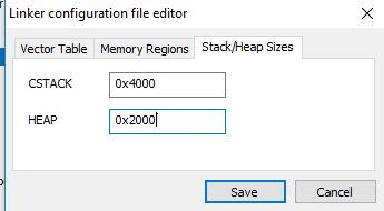

I am using STM32F746BG. I use FreeRTOS and USB CDC class code.
when I create an IAR Project using STM32CubeMX, USB com port correctly identify by windows but can not open.
but if i change code like cod below, it works correctly
int main(void)
  HAL_Init();
  SystemClock_Config();
  MX_GPIO_Init();
  /* USER CODE BEGIN 2 */
  MX_USB_DEVICE_Init();
  while(1);
  /* USER CODE END 2 */
  MX_FREERTOS_Init();
  /* Start scheduler */
  osKernelStart();
what is wrong??
mn
Posted on July 15, 2017 at 16:38
I change Heap and stack and problem solved.

‌ This seems to be a regular problem for developers. Can you ask that STM32CubeMX increase the minimum heap and stack sizes values when USB is used? This seems like something the tool can and should do for the developer.
