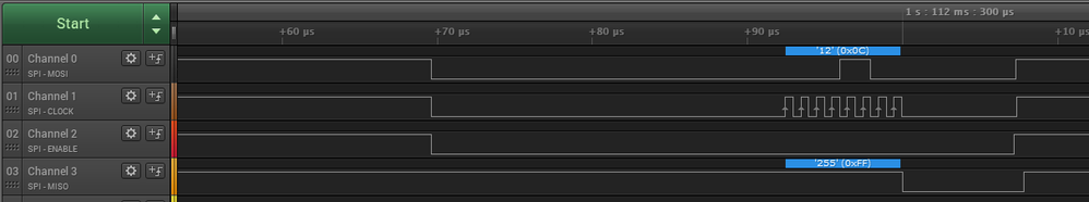

So, there should be no any SPI receivedata from MISO, but when I look the data at the logic analyzer, the MISO sent back the data from MOSI. It is like echoing, Or Is it because of the SPI nature?
this code I sent "Hello world!" the string length is 12.
First, I send the length of the string to the slave, Then, I send the Hello world! sentence to the slave.

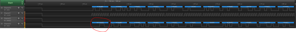

the thing is, every data transmit from the MOSI, there will be a data sent back from MISO which is the sentence of the Hello world!
example in my picture, when I send the length 12, the MISO will exchange the " ! ". which is the last letter of hello world!
Then, when letter H is being sent, the MISO will reply back the length of the string data which is sent previously. Why is this happening? anyone can help me?

So, does the copied data from MISO is stored into my master Data register? If yes, do I need to clear it with dummy read in master?
0693W00000AO3oMQAT.pngI try to send the length of the string only to the master, for the first transmission, the MISO return 0xFF, I where does this value come? is it from the register that has not yet been cleared from MISO?
because after I do second transmission, the MISO return 0x0C which is the string length that I sent before.
To confirm it more, I change the code to send "hello world!" only string to the slave. and what I found is, the first thing that MISO return is the 0x0C data which is the data that I send previously before I change the code. Is this normal for the SPI?
