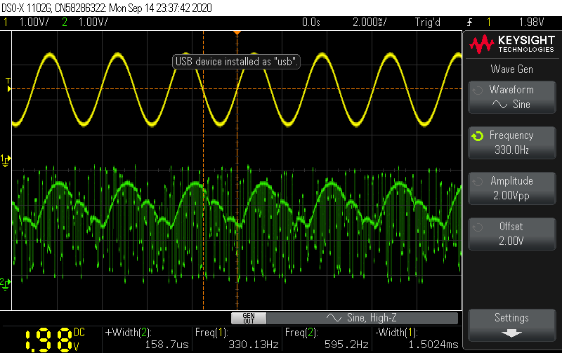

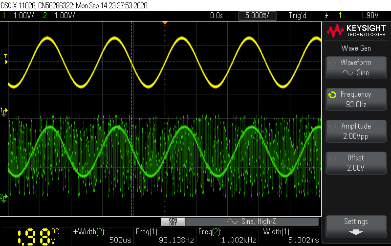

Hey guys!
I am trying to implement a difference equation into the STM32 MCU, however Iam getting this from the output of my DAC and I have no idea why this is happening?

 float ADC_Value[8]; // Hold 8 Samples
  float ADC_Value_Output[8];
  float iir_coeffs[5] = {0.00452, 0.009039, 0.00452, 1.801, -0.8189}; //B0, B1, B2, A1, A2
  float iir_mono_state[4];
  arm_biquad_casd_df1_inst_f32 monoChannel;

   arm_biquad_cascade_df1_init_f32(&monoChannel, 1, iir_coeffs, iir_mono_state);
    while (1) {
    		if (half_transfer_complete == 1){
    			GPIOA->BSRR |= GPIO_BSRR_BS0;
    			arm_biquad_cascade_df1_f32(&monoChannel, &ADC_Value[0], &ADC_Value_Output[0], 4);
    			TIM6 ->CR1 |= TIM_CR1_CEN;
    			half_transfer_complete = 0;
    		if (transfer_complete == 1){
    			GPIOA->BSRR |= GPIO_BSRR_BR0;
    			arm_biquad_cascade_df1_f32(&monoChannel, &ADC_Value[4], &ADC_Value_Output[4], 4);

  void init_Timer(){
  	RCC -> AHB1ENR |= RCC_AHB1ENR_DMA1EN;
  	RCC -> APB1ENR1 |= RCC_APB1ENR1_TIM6EN;
  	DMA1_Channel3 -> CCR |= DMA_CCR_PL_Very_High |
  							DMA_CCR_MSIZE_16_Bit |
  							DMA_CCR_PSIZE_16_Bit |
  							DMA_CCR_MINC		 |
  							DMA_CCR_CIRC		 |
  							DMA_CCR_DIR;
  	DMA1_Channel3 -> CNDTR = 0x08;
  	DMA1_Channel3 -> CPAR  = (uint32_t)&DAC1->DHR12R1;
  	DMA1_Channel3 -> CMAR  = (uint32_t)ADC_Value_Output;
  	DMA1_CSELR  -> CSELR |= DMA_CSELR_C3S_TIM_6_UP;
  	DMA1_Channel3 -> CCR  |= DMA_CCR_EN;
  	TIM6 -> DIER |= TIM_DIER_UDE;
  	TIM6 -> ARR  = 0x708;
  	TIM6 -> PSC  = 0x0;
