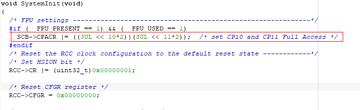

Check the FPU is being enabled, usually in the SystemInit() code, and being called from startup.s

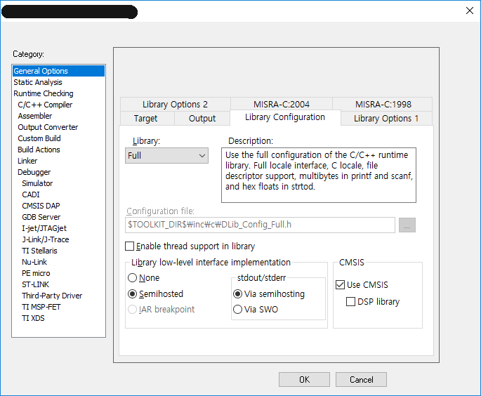

Make sure the right libraries and target processor are being selected.

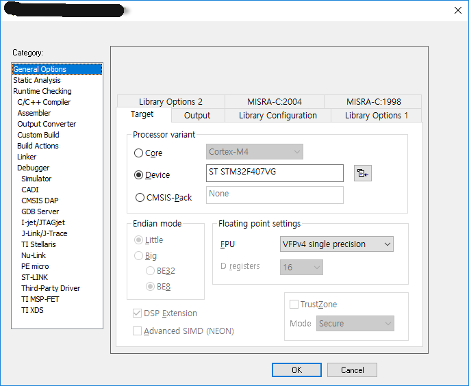

Seems you are using floating point numbers anyway. Have you enabled the FPU ?
If I remember correctly, IAR does enable the FPU automatically in the startup, if it is set in the project options (General Options-> Target, FPU).
And check the device is set correctly (STM32F407xx, Cortex-M4F).

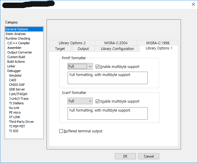

Please check that the printf formatter is set to "Full" in the project's "General Option"=>"Library Options 1".
km shim
Yes,
Target, and library configuration. and also, debug info picture as following.

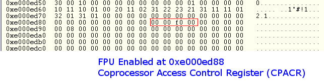

FPU enabled routine. at that time FPU coprocessor info.
