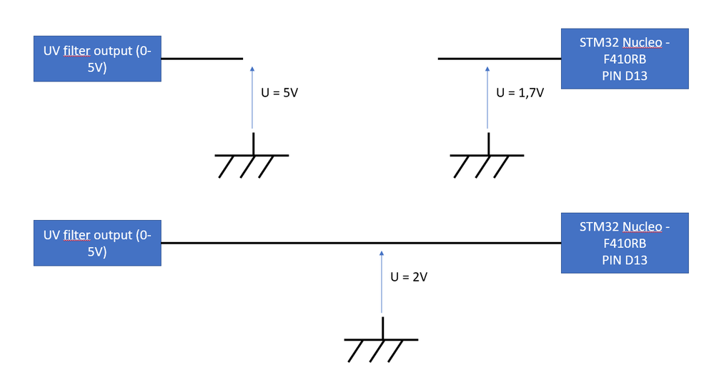

I have a UV filter that sends back a 0V-5V digital signal that I'm trying to read on PIN D13 (PA5).
The issue if the following (I'm using a multimeter to read the voltage, and all components have a common ground):
  • when the cable is not connected to the PIN
    • I read a voltage of 5V from the UV filter side
    • I read a voltage of 1.7V from the PIN D13 side
  • when I connect them both
    • I read a voltage of 2V
Even though I can interpret the signal, the imposed voltage on the UV filter makes him go into default mode.

gbm
Principal
PA5 (Arduino D13) pin is connected to an LED ("user LED") - check the Nucleo schematic.
My STM32 stuff on github - compact USB device stack and more: https://github.com/gbm-ii/gbmUSBdevice
S.Ma
Principal
And remember that analog inputs on some STM32 are 3.3V tolerant only, so don't connect a 5V signal to it, unless you made sure reading the datasheet that this is safe to do so.
