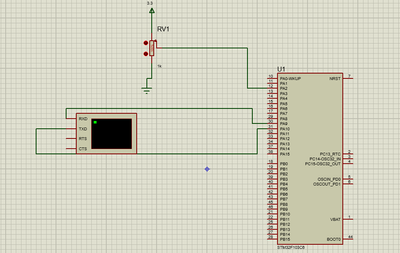

The above is my schematic layout of ,STM32F103C6 Series, attached to a virtual terminal with transmitting and receiving lines mentioned and the pin PA2 is used as an ADC input pin.

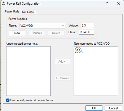

The above is the power rails configuration .

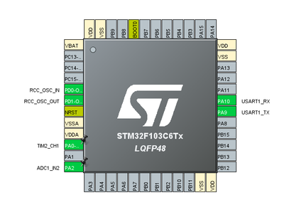

The above is the pinout view where PA9 and PA10 are used for transmitting and receiving which are attached to the virtual terminal as showed.

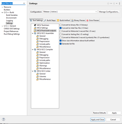

Then I have build my program and converted into hex file whereafter I copied its path to the proteus stm32 model's program file.

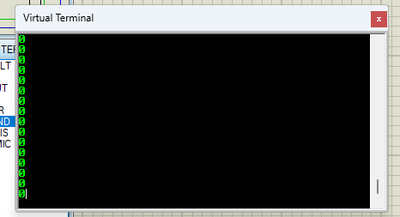

The above is the output I am getting.
I am very confused on what went wrong in my program and simulation,
