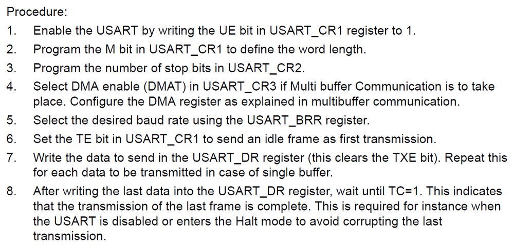

Might not be it, but the RM says to enable UE first, then do everything else.

You're still not doing the correct order of initialization. TE should be last.

Sorry about that! I was careless with the pasting of the up to date code. Here it is:
void UART4_Config()
	// Enable GPIO C
	RCC->AHB1ENR |= RCC_AHB1ENR_GPIOCEN;
	// UART4 TX PIN GPIO SETUP
	GPIOC->MODER &= ~(GPIO_MODER_MODE10);		 // Clear pin mode field
	GPIOC->MODER |= GPIO_MODER_MODER10_1;		 // Set pin mode field as alternate
	GPIOC->OTYPER &= ~(GPIO_OTYPER_OT10);	 	 // Clear output type field (push-pull by default)
	GPIOC->OSPEEDR &= ~(GPIO_OTYPER_OT10); 	 	 // Clear output speed field (low by default)
	GPIOC->OSPEEDR |= GPIO_OSPEEDR_OSPEED10_0;	 // Set to medium speed
	GPIOC->PUPDR &= ~(GPIO_PUPDR_PUPD10);		 // Clear pullup/ pulldown mode field (none as default)
	GPIOC->AFR[1] &= ~(1U << 8);    			 // Set alternate function to be AF8, bit 8
	GPIOC->AFR[1] &= ~(1U << 9);				 // Set alternate function to be AF8, bit 9
	GPIOC->AFR[1] &= ~(1U << 10);				 // Set alternate function to be AF8, bit 10
	GPIOC->AFR[1] |= (1U << 11);				 // Set alternate function to be AF8, bit 11
	// STEP 0 - Enable the bus to UART4
	RCC->APB1ENR |= DKO_UART4_ENABLE;
	// STEP 1 - Enable the UART (PC10=TX PC11=RX) by setting the UE bit (uart enable bit)
	UART4->CR1 |= (USART_CR1_UE);
	// STEP 2 - Set the M bit
	UART4->CR1 |= (USART_CR1_M);
	// STEP 3 - Set the stop bits
	UART4->CR1 |= (USART_CR2_STOP_1);
	// STEP 4
	// NONE
	// STEP 5 - Set baudrate to be 19200; formula is BRR = [pclk + (baud/2)] / baud
	UART4->BRR = 4376;//2188;
	// STEP 6 - Set the TE bit
	UART4->CR1 |= USART_CR1_TE;
