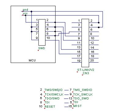

I have a ST-LINK-V1 connected to a OLIMEXINO-STM32, an F103RBT6 using the System Workbench.
Using the ST-LINK utility I can see that I communicate to the ST-LINK. I can flash the com light and change basic configuration.
But when I try to connect to the device it times out without much feedback as to why.
Trying to connect for debug on the WB there is more detailed information.
It seems to connect, I see the unit voltage but it says '0' breakpoints and something about not connecting through JTAG even though i have SWD selected.
Since I an writing this from my cel phone, I'll submit this and go to the computer to to collect images and data and post a subsequent post.
davidmodulartech
Posted on November 08, 2017 at 19:23
I'm fine now. Lovely to see it working properly!! Serial com interface debugging is very tedious!!
I removed TDI and SWO, oh and uh, SWCLK was actually connected to GND. Ooops. fortunately ST designs for 'anything can happen' environments.

I used this connection scheme:
I went to have a look and most don't seem to have SWO nor TDI connected. Will this make a difference?
The next is to see if I stepped on any DIO pins.
davidmodulartech
