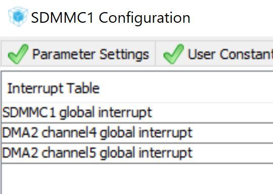

GreenGuy
Lead
Posted on March 08, 2018 at 18:01
Sorry, the website is not taking my snips so I will have to describe what I see in CubeMX.
SDMMC1 Configuration:
1. NVIC Settings: I show in the interrupt table SDMM1C global interrupt Enabled
    and DMA2 stream3 global interrupt enabled
2. DMA Settings: I show SDMMC1 under DMA Request, DMA2 Stream 3 under Stream, Peripheral to Memory under Direction, and Priority Low.
DMA Configuration:
1. DMA2: is the same info as DMA Settings from the SDMMC1 configuration window.
I notice that the TX and RX options in the DMA Configuration showed RX and TX options in red.  So I deleted the DMA2 selection and went back to the SDMMC1 settings.  There under DMA Settings I added the SDMMC1_RX and TX streams.
The FRESULT is 35 which I am not sure what that means.  However the  f_printf function returns immediately and now the f_close function takes about 15 seconds to complete and returns with FR_DISK_ERR.

GreenGuy
Lead
Posted on March 08, 2018 at 20:18
I have traced down to the problem.  When f_close is called, the function SD_write gets called to flush the cache finishing any remaining writes that need to occur.  In SD_write, BSP_Writeblocks_DMA gets called which returns an MSD_OK status.  Then a Global variable WriteStatus is checked indicating the write has completed but it never gets set to 1 so a timeout period elapses.  The WriteStatus variable is set to 1 by the callback BSP_SD_WriteCpltCallback.  I can not see anywhere in the code generated by CubeMX that BSP_SD_WriteCpltCallback is referenced so it can respond to the TX DMA interrupt.
